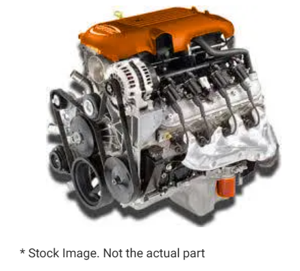

Did you check the engines belts - see if the Gas engines' Alternator belt to it's pulley is working?
Representative image...but the issue is the serpentine belt and alternator for charging it's system.
