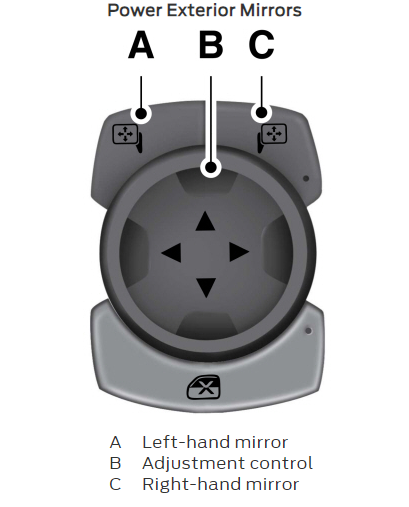

How? This runs on DC power, so a simple DC motor can run in one direction - but if the wires are reversed as in reversed polarity - the motor goes (spins) in the other direction.
So, if you have "up" that's half the battle - but the wires still need to be reversed so the Mirror may still be ok, but the door panel will have to be removed to get access to the Mirror control (Or the dashboard - depending on the trim and year) and see if the logic in it is faulty - it's the more expensive one to replace (home and directional key)
So to help see if up and down work on the PASSENGER side...
Does it?
Ok, then the LOGIC UP and DOWN work, so this isolates to a wiring issue to the Drivers' side mirror (left one I hope)
